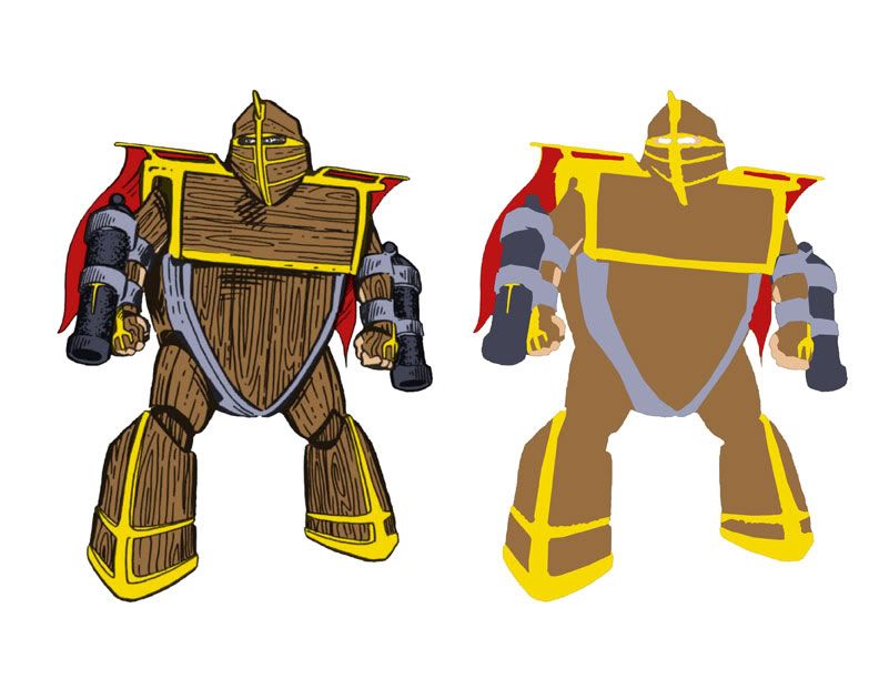

Here's a V&V Jeff Dee piece I was practicing with... I'm NOWHERE near Mancer and other colorists, but I'm teaching myself. I also haven't yet added in much shading or effects on this character. (any suggestions Mancer??)
Here's the image with it's line art and without for comparison... As you can see the non-line art one on the right looks like a sloppy kids art project, but layering on the art makes it look better...

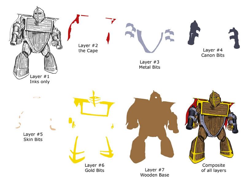

Crap... I suck at explanations... A picture's work a million words. So here goes...
This is a quick break-down of my SIMPLE layers. Remember I'm still learning and this is a new trial, no shading or anything's been added... I'm hoping with some suggestions I will contine this pic along in this tread.
So you can see the individial layers I'm currently working with. The top layer (layer #1) are only for the inks. I currently make this layer which is actually just a cleaned up scan of the art that is full black and white. Meaning it IS NOT just the black inks... I chose the "MULTIPLY" option on this layer (located at the top left of the layer palette) which basically makes all the non-black lines overlay ontop of anything beneath it, making the WHITE areas of the picture (anything NOT black in this case) ttranslucent.
This layer lays on top of all the others, which as you can see are seperate. SO I can easily take the layer that is the CAPE and change it's color, contrast, etc... without effecting ANY of the other layers/colors...
I do the same sometimes if I want to turn or move things on my original artwork. For example. If I wanted to tilt Armada's head so that he's looking down at the ground... Or maybe raise one of his arms. I can select just that area make it it's own layer and move it as I like...
